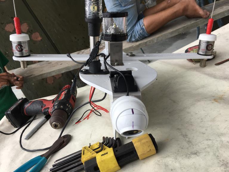

I’m way late on this conversation, but I have 2 Metz VHF antennas on my mast head unit. 1 is for the VHF and the other is for the AIS. The AIS one has an antenna splitter on it so I can utilize it as a spare if the main one or cable fails. Note that I pulled RG8X cable, which is extremely low loss, and I’m amazed at what I can pick up that other boats can’t.
I also installed a video camera with a polarizer on it which feeds the the display on my B&G chartplotter. We spend a lot of time in reef/coral strewn areas and this really aids when maneuvering in these areas, especially when the charts are completely unreliable.
Note that the the wind device mounts just above the camera and the windex mounts on a bar which protrudes aft. This is a very busy masthead unit.

Hi Geoff
That is such a good mast head unit. Certainly gives me pause for thought.
