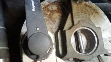

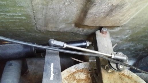

Pictures? Sounds like your rudder shaf above the quadrant is unsupported. What is bellow the quadrant? And any chance you can attach your linear drive to the quadrant and preserve the use of your emergency tiller?

I happen to currently have the stern panel off on my F-30 looking for a leak.
So I took a couple of pictures with my phone looking from as far above as I could reach showing my linear drive installation.
Note - the top of the pictures is the stern of the boat and the emergency tiller still goes over the bolt and inside the top of the shaft.
The linear drive is attached to the starboard part of the stern and the connection to the lever arm is made below the arm.
Hope these help.

Erik, this is extremely helpful and looks exactly like my arrangement looking down on the quadrant disc.
So the tiller arm fits right over the rudder post that is good!!
On my boat the emergency tiller bolt sticks out either side of the post, hex head one side, nut on the other. Does the tiller arm fit over the bolt or on top of it?

The linear drive tiller arm is a standard Edson part and blowing up the pictures I took it looks like:
712
325 - 18
Edson
C - 4??
In the pictures it looks like it is over the shaft bolt, but I can confirm that when I get back to the boat on Friday.
