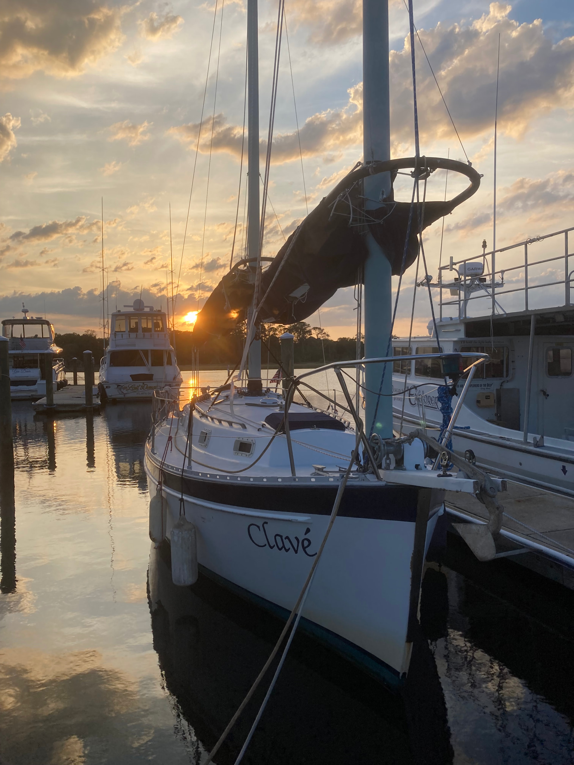

My boat was built in Hamble in 1981. 1981 Freedom 28 Cat Ketch hull 112 . It was christened Freeform. The first owner,Patrick Cobhan, sailed the North Sea, Mediterranean, Atlantic, and Caribbean. He sold it to a gentleman in Florida.
I have owned Clave’ 13 years. .jpeg)
