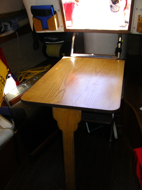

got my f25, and already working on a design. still would like to get a pic of existing table can anyone help?

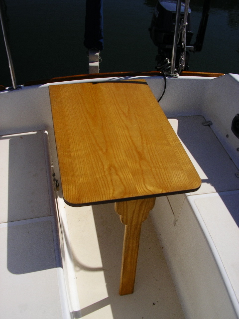

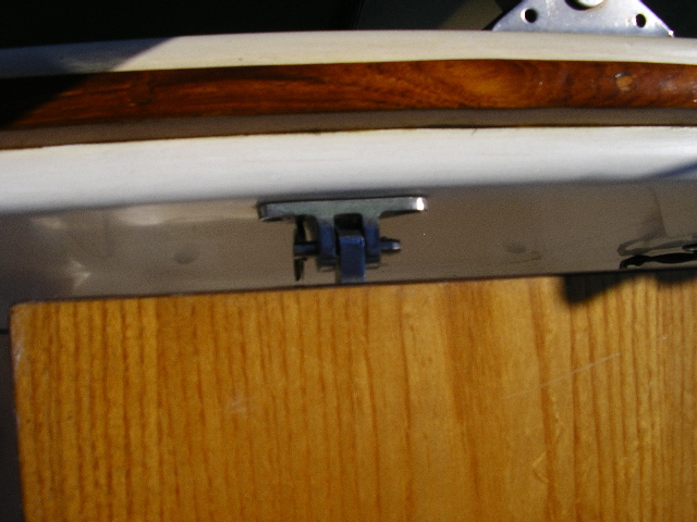

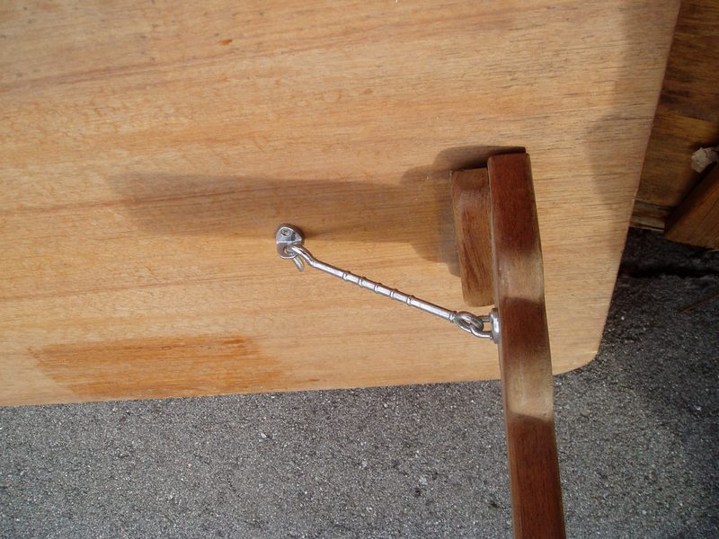

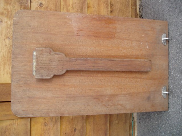

Here are some pictures of my table. It needs a bit of TLC which I will apply if I ever actually start using it. It is constructed of plywood with a solid wooden leg.

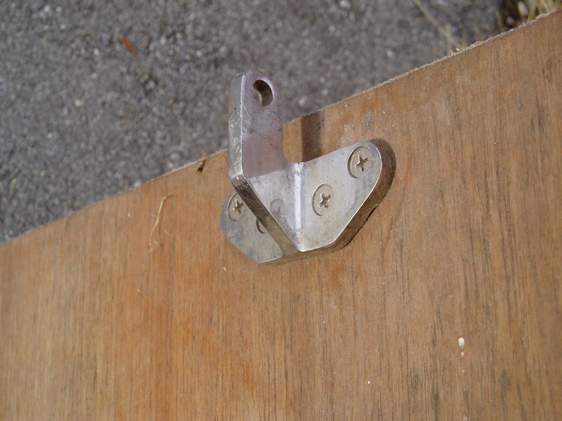

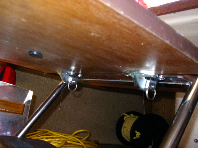

Note the mounting brackets on the back of the table. There should be matching brackets on your companionway stairs, and at the back end of the cockpit.

Can u post pics of it set up, with u holding up side that attaches? Will get scale,
Nice - clean: where did you get the hardware ?
This is the original table that came with the boat. The hardware is all original. It is snowing out now, but the next nice day I am down at the boat I will take a picture of the bits that are attached to the boat.
This must be pretty standard stuff. Surely any big boat supply house or camper trailer supply would have several varieties of table mounting hardware.

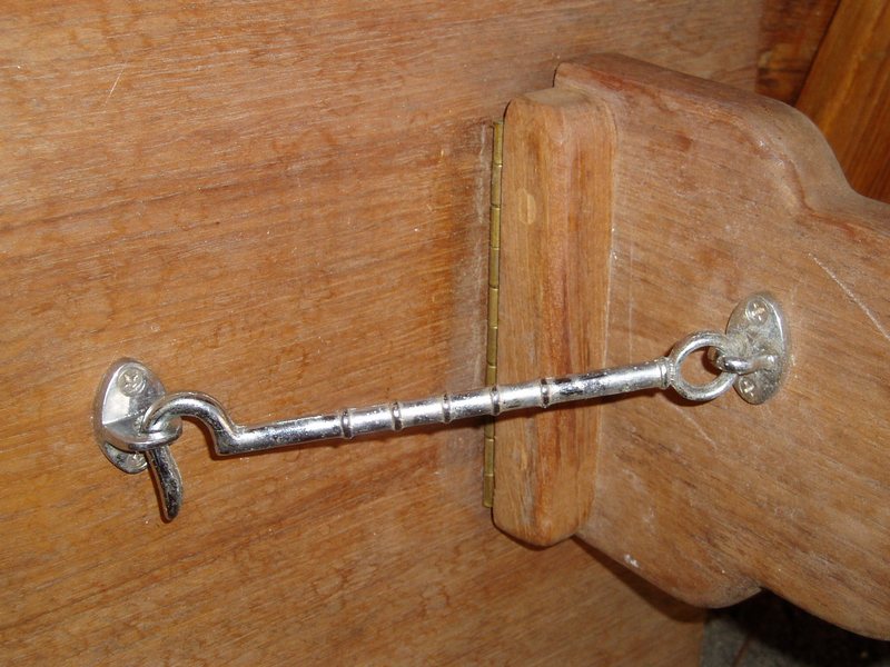

Yarrow, here are some pics I took of the table in my previous boat.
a couple more pics:

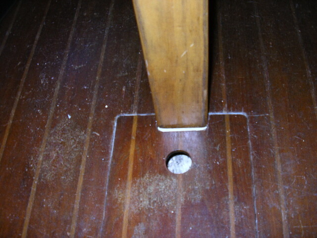

I have a table, and have all the concerns other people have had. I have muscular legs, and there isn’t a lot of room between the bench and the bottom of the table for my legs. It would be nice if it was a bit higher. Maybe I could make a new one, or adapt this one. The pins are a bit difficult to insert, so maybe I would create something that snapped in?
