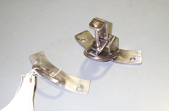

In my case I had a custom stainless bracket made (I considered the garhauer mast collar but went a different route). It bolts down using 2 of the of bolts that go through the mast collar itself. This seems very strong. A picture is attached.
What you see in the picture is the original bracket when I only had a vang and the new bracket with the swivel for the boomkicker welded in.
