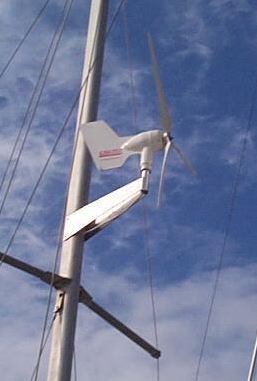

I’m now thinking about either the new Air X Marine or the KISS generator. The developer of the KISS has an interesting way to mount the unit on a mizzen (or main). He uses a very short vertical pole, which makes the unit wobble a lot less. on the mounting ring of the KISS unit, there is a limiter to prevent the unit to turn 360* (aft of amidships), so the blades won’t hit the mounting bracket. After all, mounted in front of a mast it will not produce energy well when pointing aft. I found that a very smart thought.
Michel, that is reassuring to hear that the new AirXmarine is quieter, that will certainly be a bonus. A friend of mine did a lot of research on this subject and concluded that the aero6gens were the best units especially for noise. I looked at one of these but the power output was lower, the installation more difficult and the price was higher by about 50%, though I am sure it is a very good product. The Kiss generator looks a nice simple arrangement, How does it compare for power output? Kind regards,
