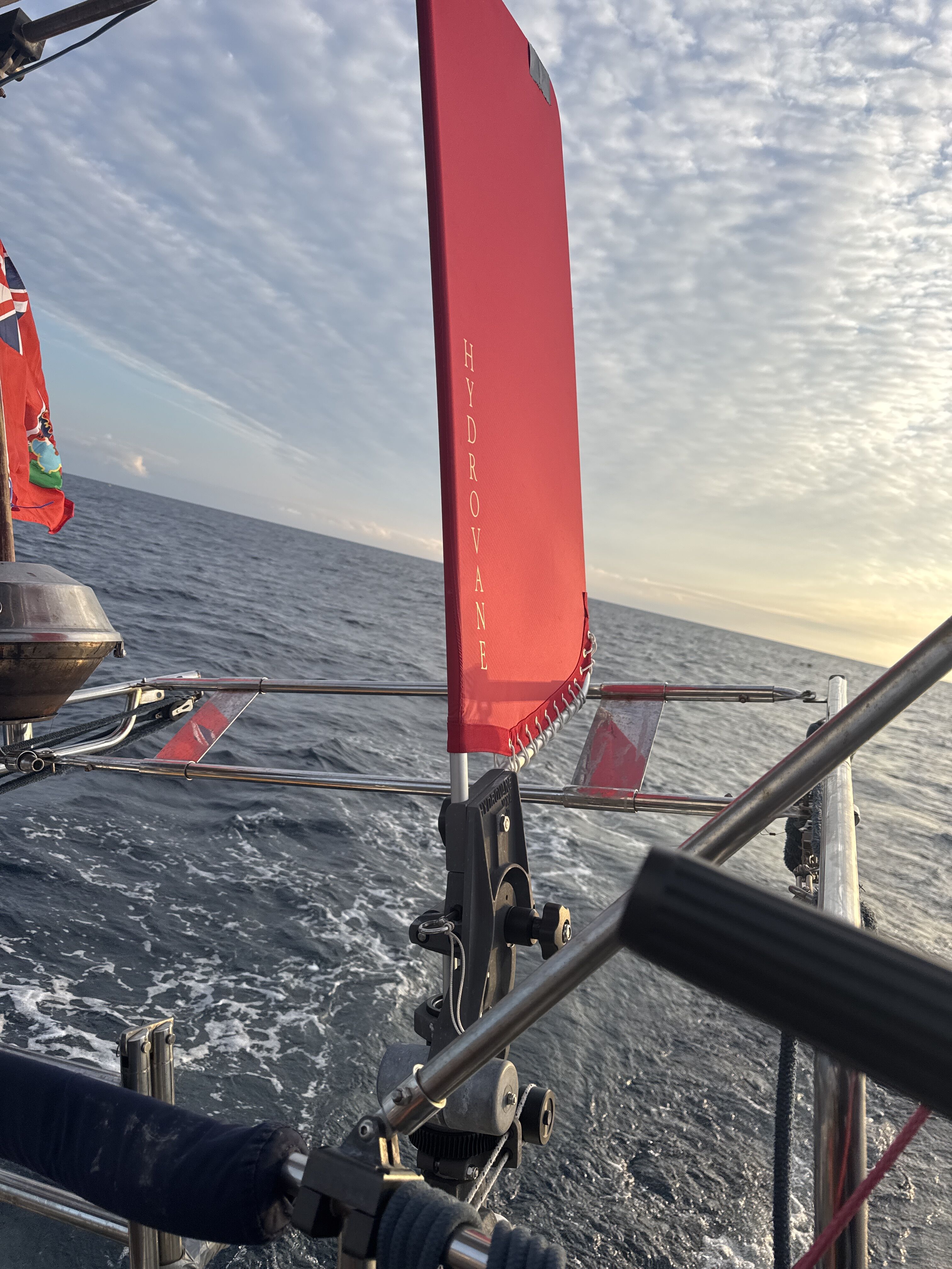

I fitted a hydrovane on my F32 and just completed a crossing from Bermuda to the Azores (it is an absolute beast!) and it looks very tidy as it is completely self contained with no lines leading anywhere. It fits JUST below my solar panel arch and JUST above my davits.

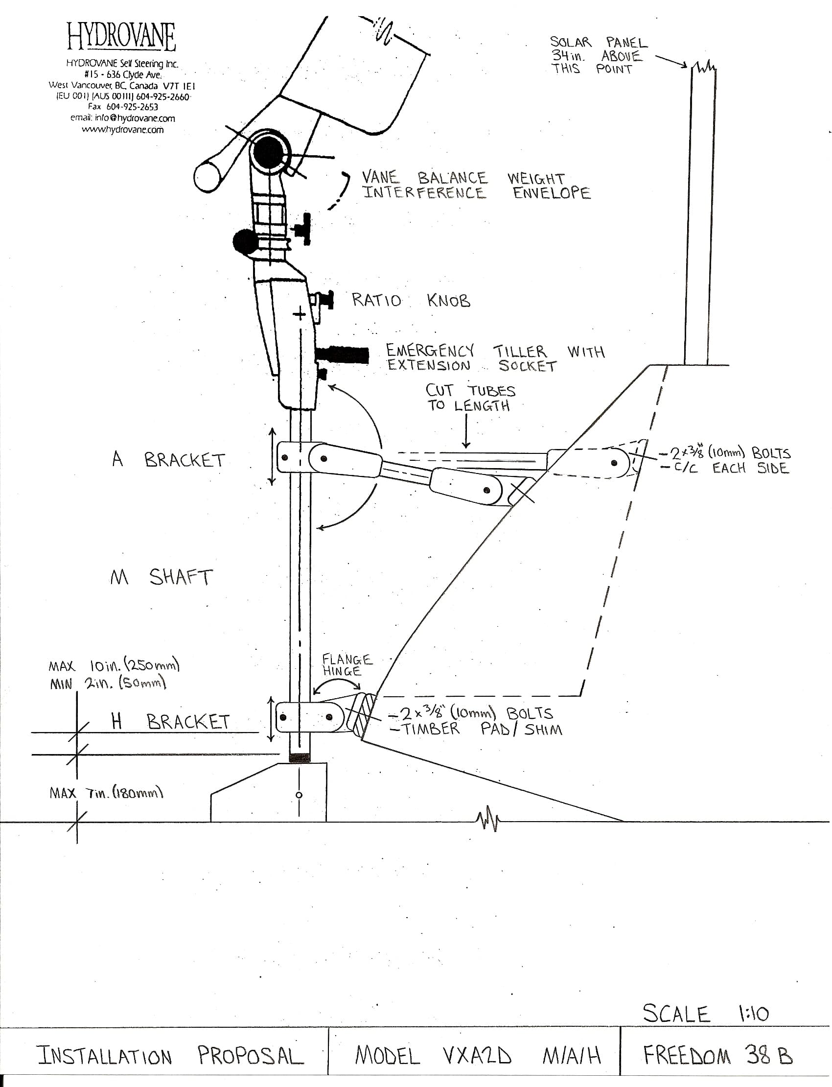

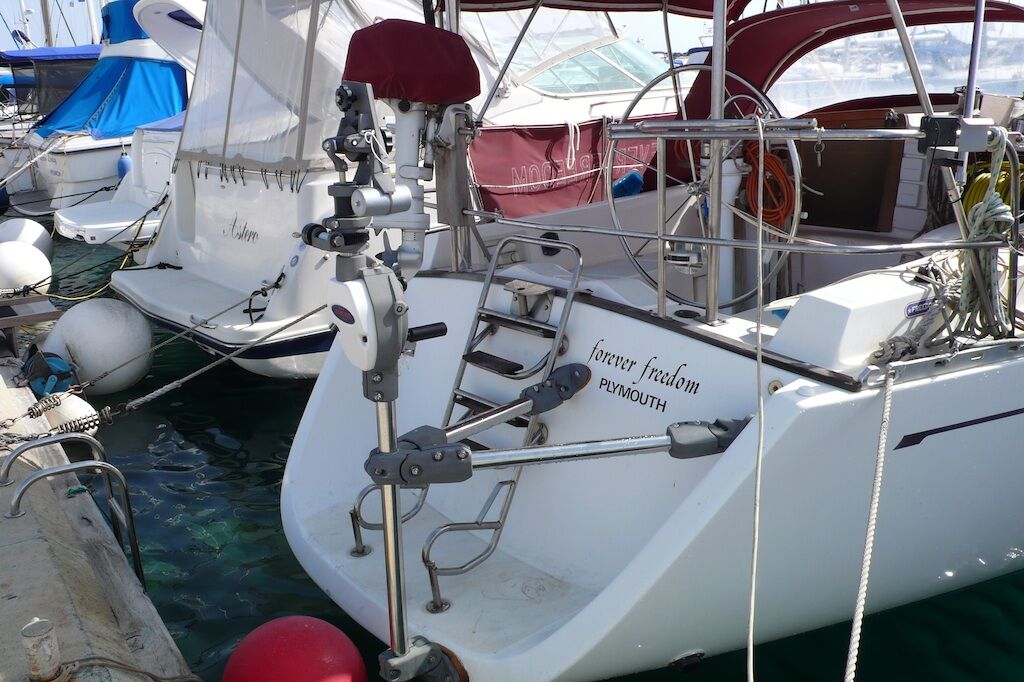

This is a drawing they sent me that was made for another customer with a F38. The fact that it can be offset without affecting performance is really nice, and something you can’t do with a Monitor wind vane.

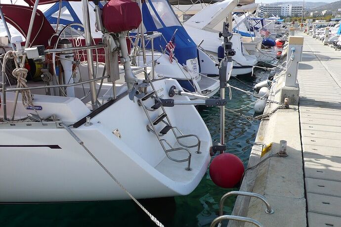

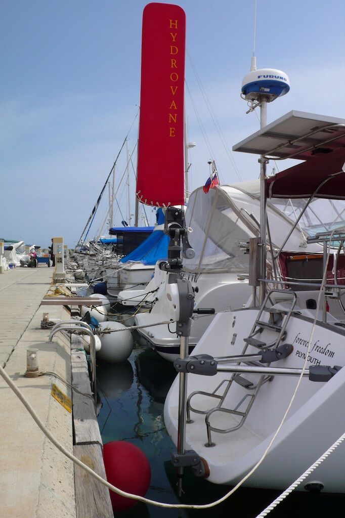

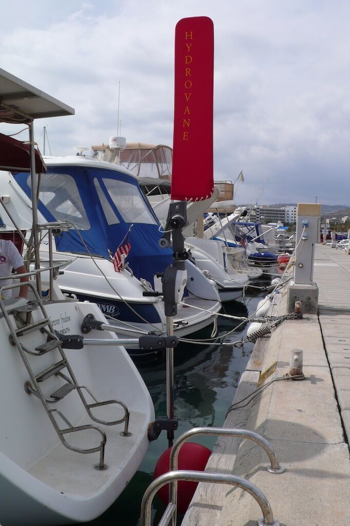

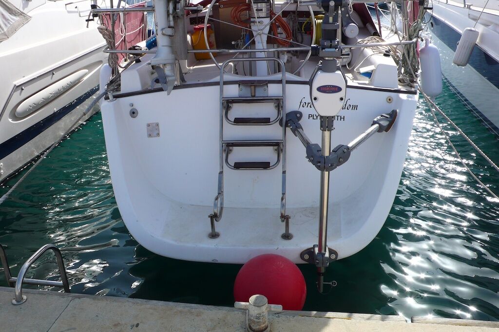

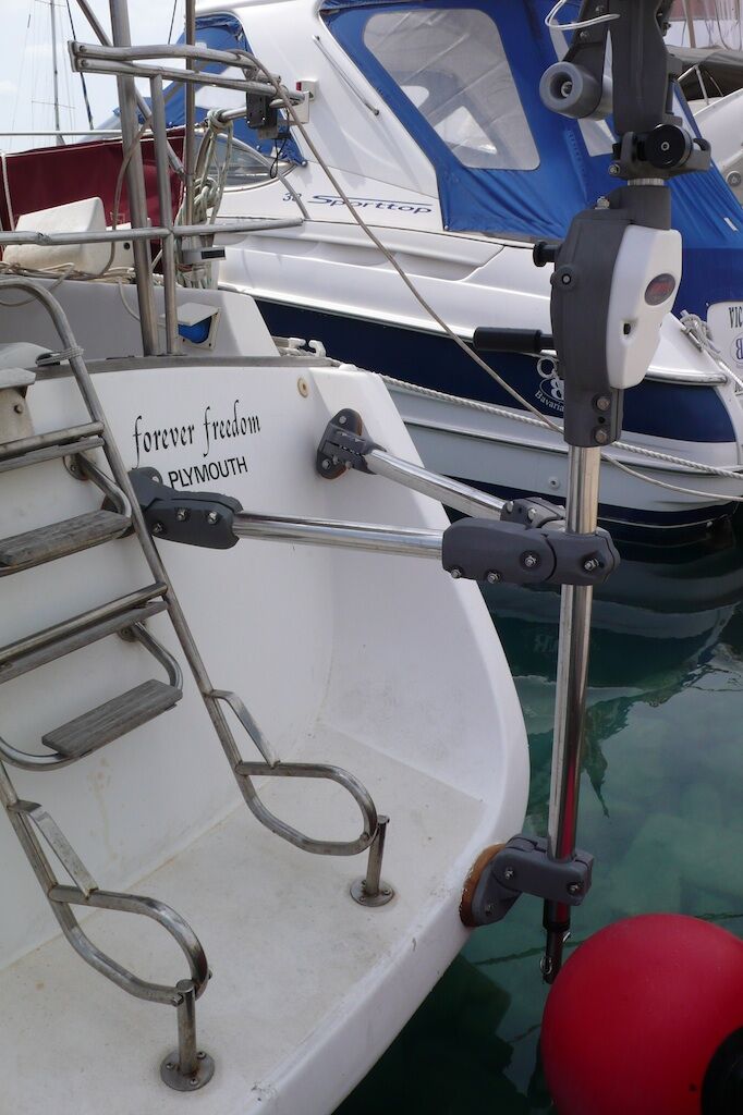

They also sent me these photos from that customer’s installation. Definitely a nice setup for the boat, but it wouldn’t have worked with my davits.
I really like the Hydrovane, it’s a great windvane, but I must admit the price makes me wonder.
Thank you for those great pictures. The Hydrovane anchors look massive compared to other windvanes. This emphasizes the role of a second rudder that the Hydrovane plays. Which makes me think the level of stress transmitted to the sugar scoop. I wonder how the stress will play in the connection between the add-on sugarscoop and the main hull/transom on a F38. I have never checked how the sugarscoop is attached but I should look into that.

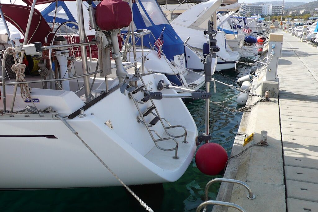

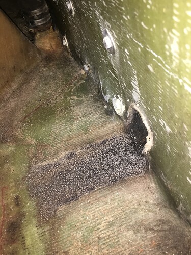

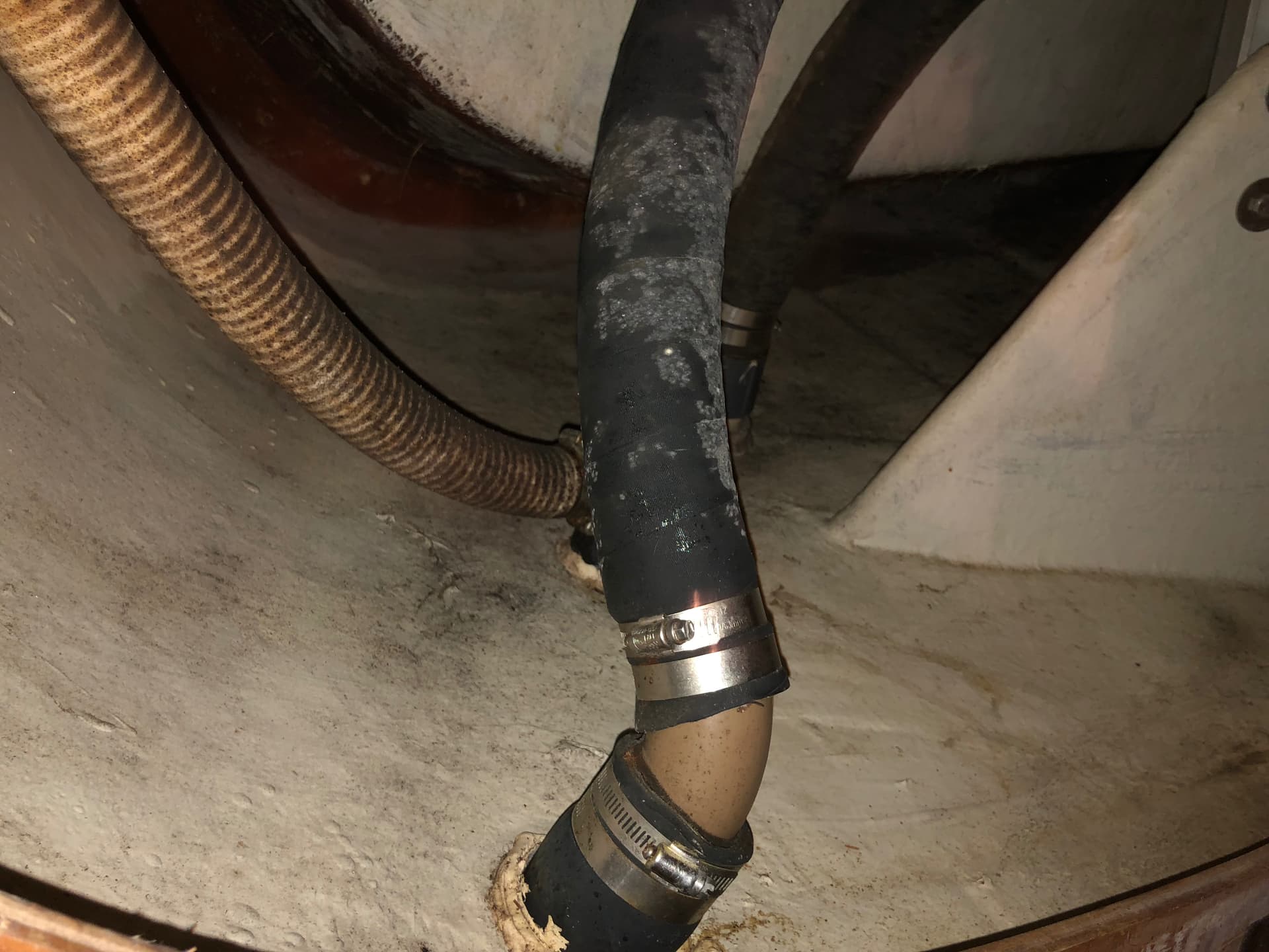

If you have an add-on sugar scoop, then it is bolted onto the transom and bedded with 5200. It’s part of the hull, and should be plenty strong. After 1988, the mold was modified to include the sugar scoop. You can see the difference in these two pictures.
Valuable info. Mine is 1988 so probably has the attachment. I noticed last year a fine line on one side of the hull that made me think is the join between the two pieces but I will investigate in more detail.
Easy way to find out is if there are any access ports on the sugar scoop. The add-on scoops had 6" screw in deck plates on either side of the inside of the scoop. This allowed them to reach in and tighten the nuts during installation.
Yes it has the deck plates on the sides and also one on the landing section of the sugar scoop. I should check on those bolts.
