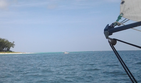

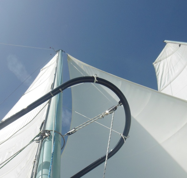

Photos:

That’s a very neat solution! I don’t have tracks. New sails will be attached by parrells, so the chocker needs to also slide up and down to adjust and reef the sail. With the setup I can see in your picture, how do you prevent the boom to move/swing sideways and bang against the mast?
…a back-of-the-envelope diagram of the rigging would be very useful… :mrgreen: :mrgreen:
Many thanks!!
