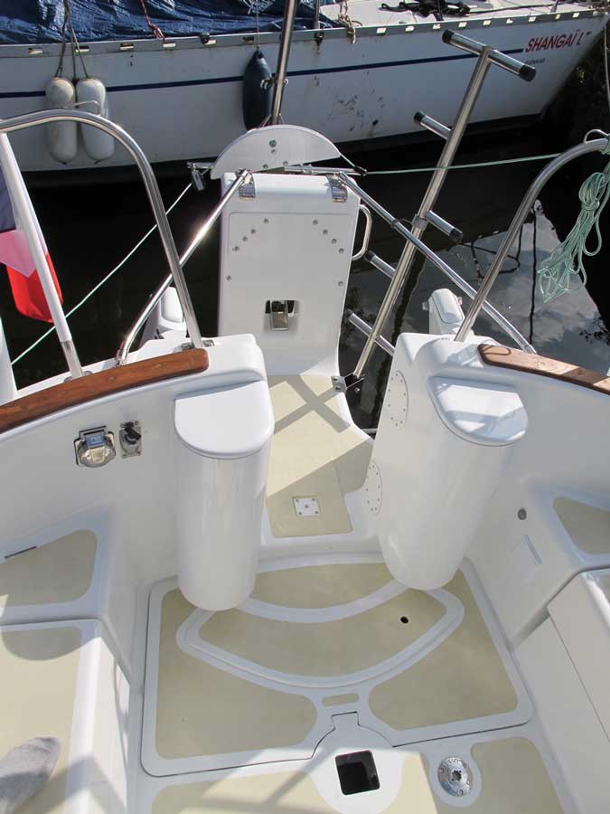

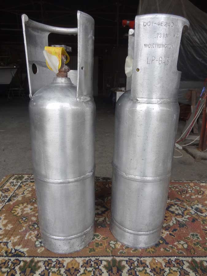

On my Freedom 33, which now sails in France, I have kept the two 6lb aluminum gas cylinders. I could have replaced them with two newer laminate cylinders, but I found that the shape of the Worthington cylinders was perfect for easy storage on board.
The rear of my F33 has been significantly modified, and I found a new location for the two cylinders, which I think is perfect.
You can guess where it is just by looking at the photo.

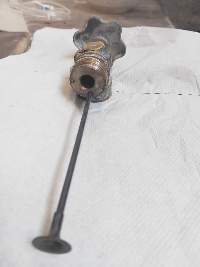

The two gas cylinders date from 1980. I believe they are still in good condition, but I cannot fill one of the two bottles.

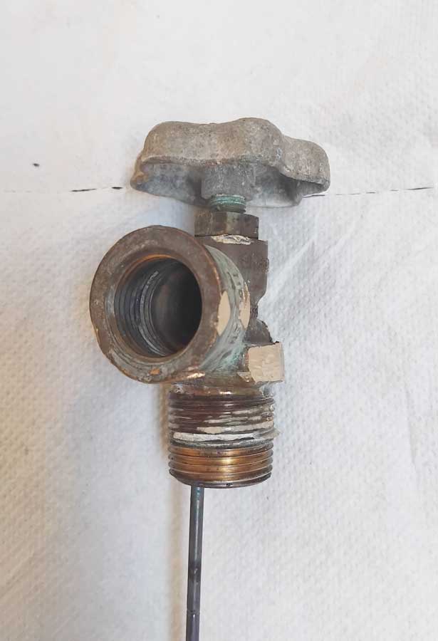

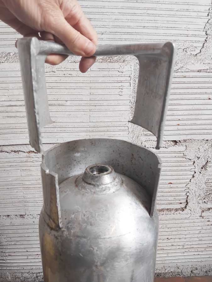

So I decided to dismantle the valve on the bottle in question. My first attempt was a complete failure, as there wasn’t enough room to move the wrench. So I decided to cut off the top of the cylinder.
Then I heated the aluminum near the valve a little with a blowtorch, and the valve began to unscrew.

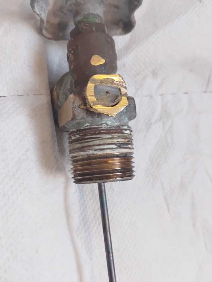

Beforehand, I had cut off part of the valve to allow better access for the wrench.

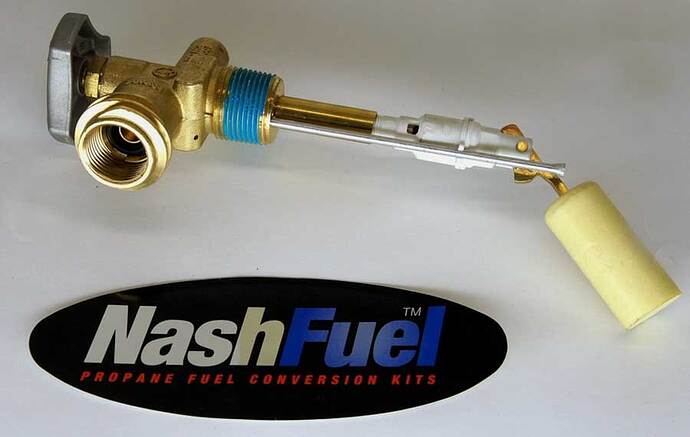

The question of replacing the valve now arises, and that’s where the doubts come in. If I understand correctly, cylinders from that era were equipped with POL valves.

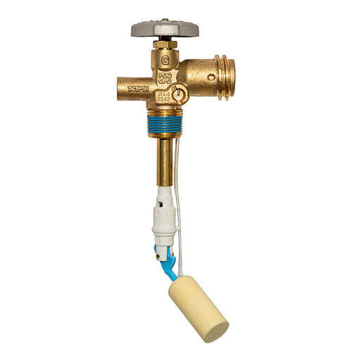

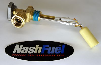

However, the valves currently sold for 6lb Worthington cylinders are equipped with OPD valves. I believe these valves can be used with the old fittings, but this needs to be confirmed. Furthermore, my cylinders are marked DOT4E240, but what I find on eBay is the DOT4E260 valve. I can’t figure out what the difference is.
The eBay page:

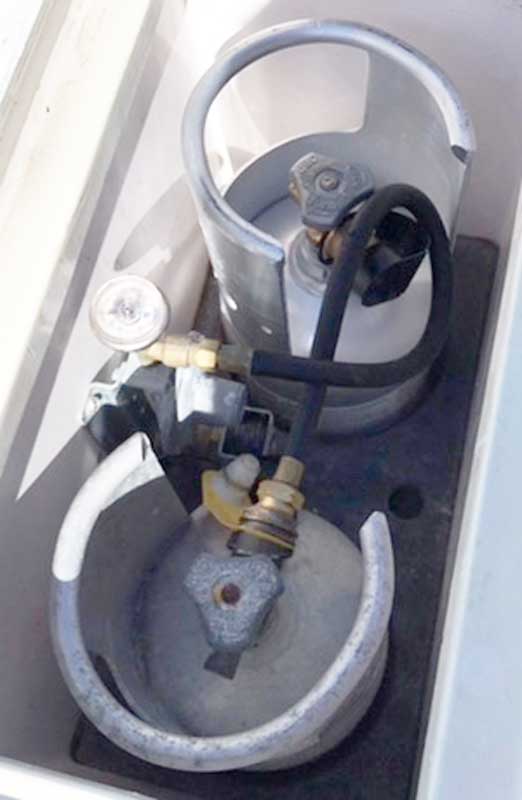

This is also confirmed by a picture I found in an old forum archive, taken by “Camillo,” owner of a Freedom 35.
The valve supplier, “Propane kit,” on eBay provided me with the answer to another question.
The old 6LBS cylinders (like mine) of type DT 4E240 are therefore being replaced by those currently available on the market, the 6LBS DOT 4E 260.
The DOT 4E240 is set at 375psi relief.
The DOT4E260 is set at 400psi relief.

The only issue with the new OPD is the length of the float. it can be too long to negotiate the body of the narrow tank. But there is a pretty simple fix, cut the float down to size. They are a solid foam material.

In fact, the company “Propane-kits,” which sells the DOT4E260 valve on eBay, can ship it to France.
But I still have the following question: can a valve that is set at 400 psi be installed on a cylinder that was equipped with a 375 psi valve?
I tend to think it’s possible, but my doubts are preventing me from taking action!

If I can’t find a 375 psi valve, I’ll have to buy the 400 model because new cylinders are really too expensive for me. A pressure difference of 6.6% doesn’t seem significant enough to me that the cylinder couldn’t handle this slight increase.

By chance, I stumbled upon the eBay page of the seller Propane-kits, who is once again offering 240 OPD 375 psi valves for 6-lb cylinders.
There were only 10 left, and 93 had already been sold. They’re selling fast!
It still cost me about $100 with shipping, but in the end, it’s much cheaper than a new cylinder.
