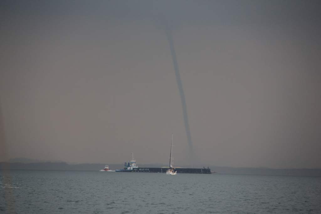

BTW, is that a waterspout in the background on the top 2 pictures?

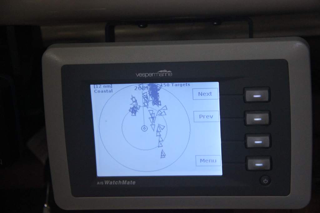

Hi Geoff, thanks for reply and sorry about accidently posting pictures twice. Theres lots of controversy about what size filters to use, alot of people are suggesting that 30micron for the primary is the way to go? The problem I have with that is I can see the secondary will plug more often and I would rather change a primary at sea. Never had fuel problems before but are now quite good at changing filters. Yes after dodging 150 ships in the Singapore strait my engine once again depowered just as a water spout developed and started heading down the channel at us. Another point of interest is, due to such heavy shipping traffic a number of cruisers had their Raymarine chartplotters shut down as the AIS targets overloaded them all this while jet fighters are screaming overhead and the VHF is as good as useless due to ridiculous amounts of traffic. Only 2 days before we were still getting coconuts from canoe paddling Indonesians you can imagine the contrast. Fortunately my AIS is a stand alone unit therefore chartplotter didnt fail which was good as after waterspout a squall came through that destroyed visibility. Tying up at raffles marina felt very good.

P.S. Multiple times I’ve had my RayMarine C80 and NorthStar chartplotters completely overrun with AIS targets and had no problems. Go through NYC sometime! I see them max out at 100 targets.
