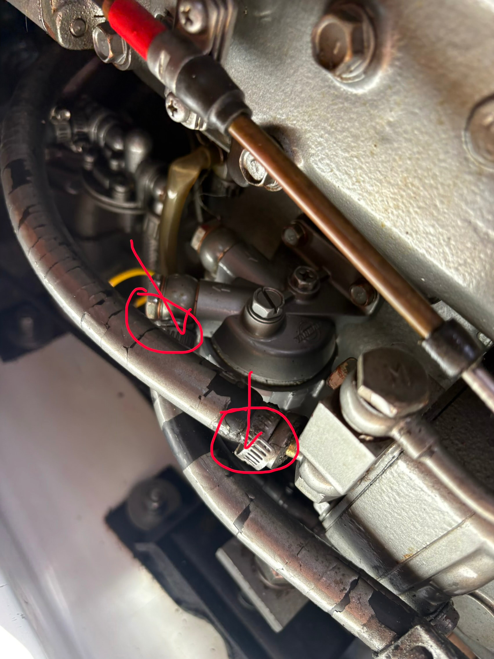

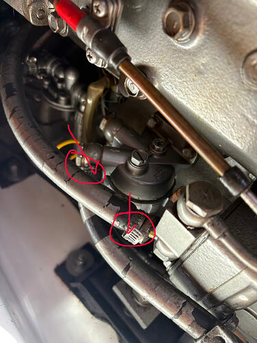

Finally back at the boat - racor looked great, secondary filter cup brim full of fuel, - bled all and still wouldn’t start - it would crank and run for 2 seconds and die. Noticed 2 hose clamps loose - return fuel line?- tightened- motor fired up Bled again while motor running - good fuel pouring out so good Started and stopped several times so hopefully that was it :zany_face:

BTW - In the picture above the hose with the clamp on it looks like it might have a little crack-split. Might be worth replacing. Could just be the picture lighting and peeling paint.
Pearce- O brother I think you’re right (and I hope you are right! :laughing:) I’m at the boat next Tuesday- Wednesday so I’ll replace anyway - looks like 1/2” ID fuel hose. New clamps too.
