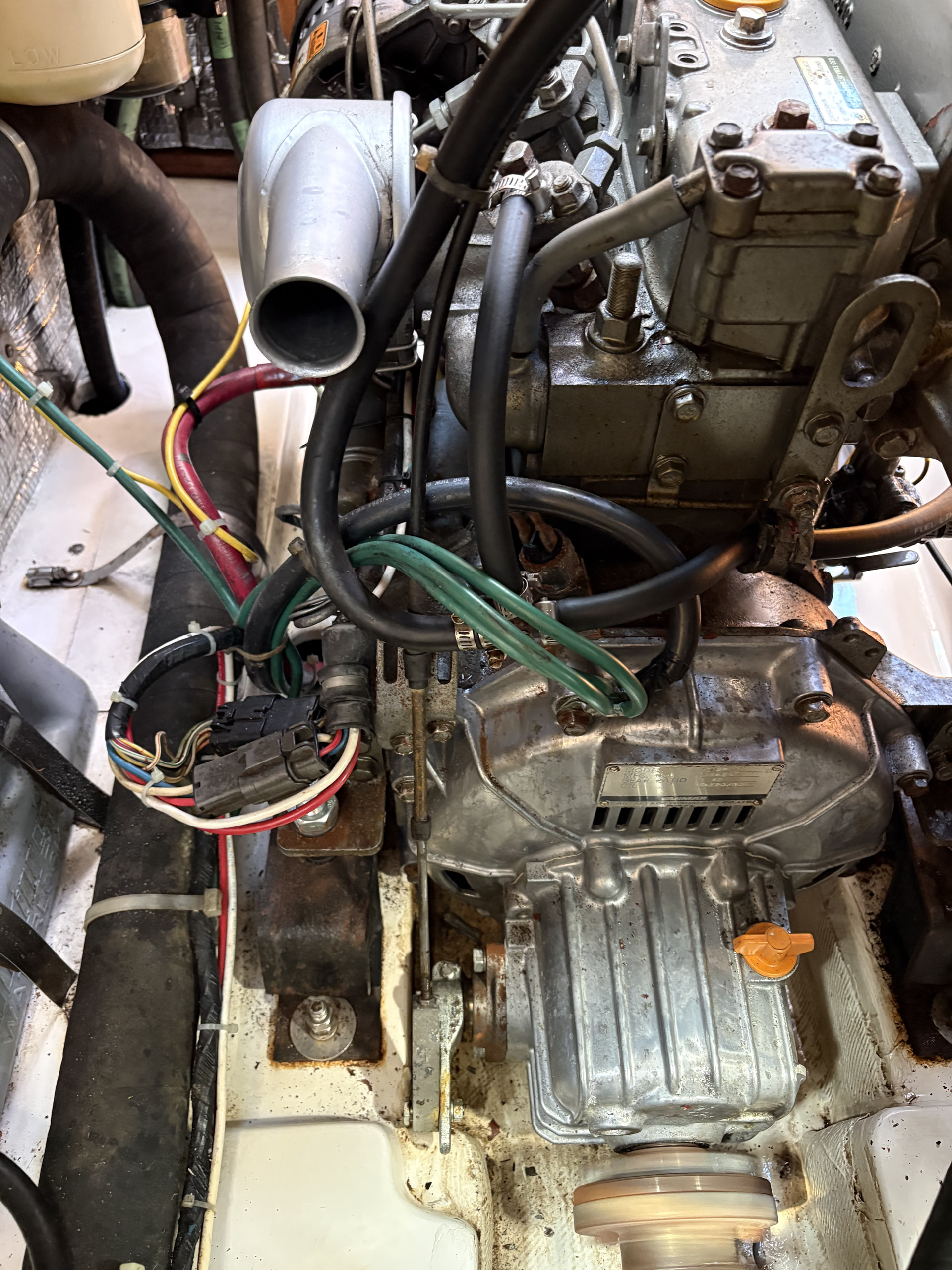

I hope yay. Played a round of the 3 bears - bought 1/2” fuel line - tooooo large, bought 3/8” line, too large, bought 5/16” line - just right
Replaced 3 lines, bled all and started. The clean black hoses are the ones I replaced

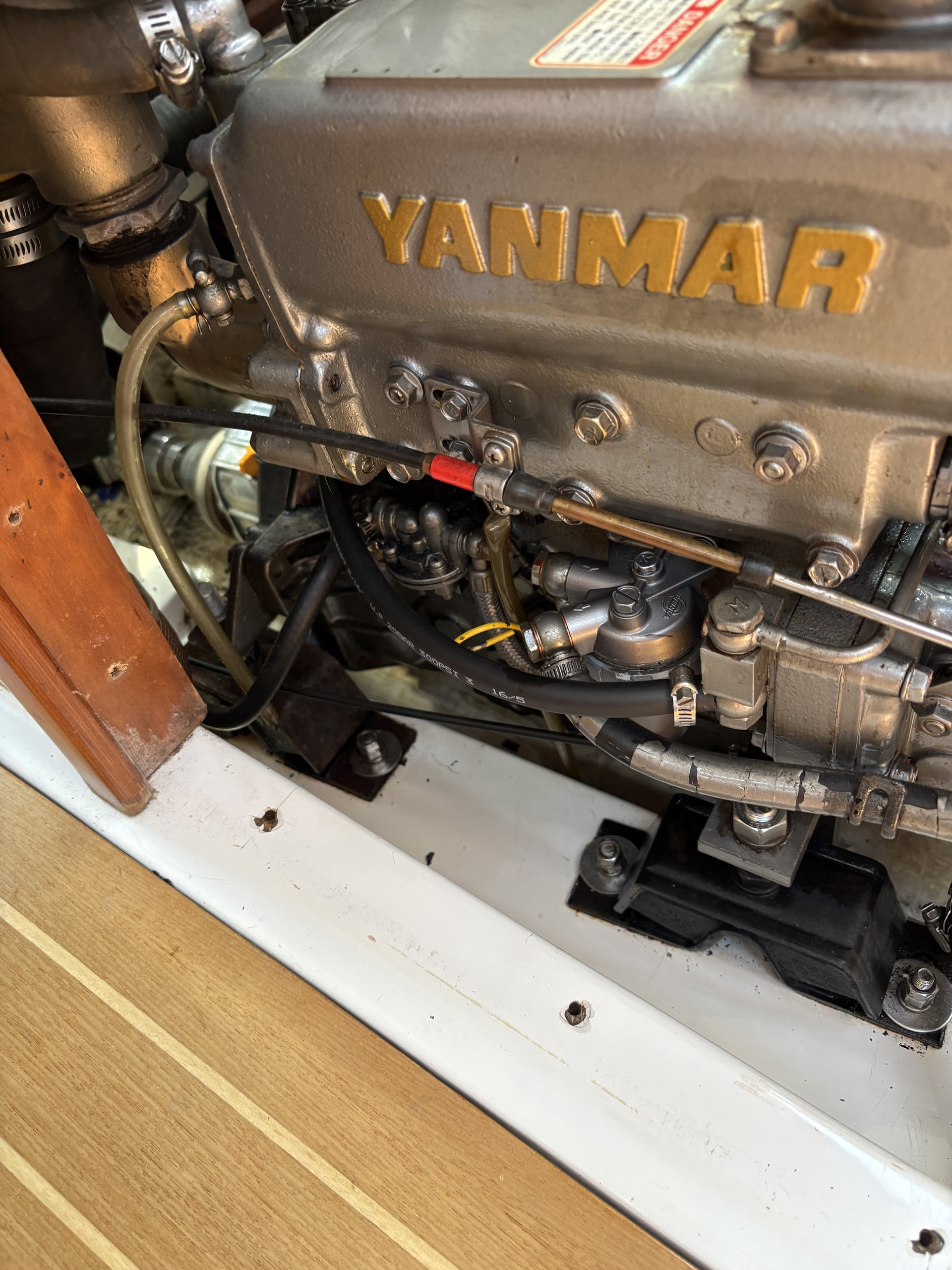

Hopefully I have this one figured out - replaced fuel lines, bled and engine fired up at dock. Did notice my secondary fuel filter bleed bolt/screw seemed wonky. Looked again at it and it was stripped- screw would start to tighten after bleeding but would not snug up. With a bit of pressure it would just keep turning. I ordered a new bolt on fuel filter unit - Amazon $69- arrives today so I’ll see how this goes but feel confident that’s the issue. Motor would run at dock but when taking out any bump or rocking/ vibration would cause air to intake into fuel line and kaput
Final note— I wanted to thank everyone who chimed in with suggestions for the air in fuel line dilemma. I did add a new secondary fuel filter unit. In doing so I did find several loose hose clamps ( on hoses I hadn’t already replaced), and when I put a wrench on my new crush washers to make sure they were crunched on tight, I found I could easily crank another 1/2 turn on all of them! So system is back running and I’m a happy camper
