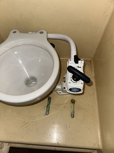

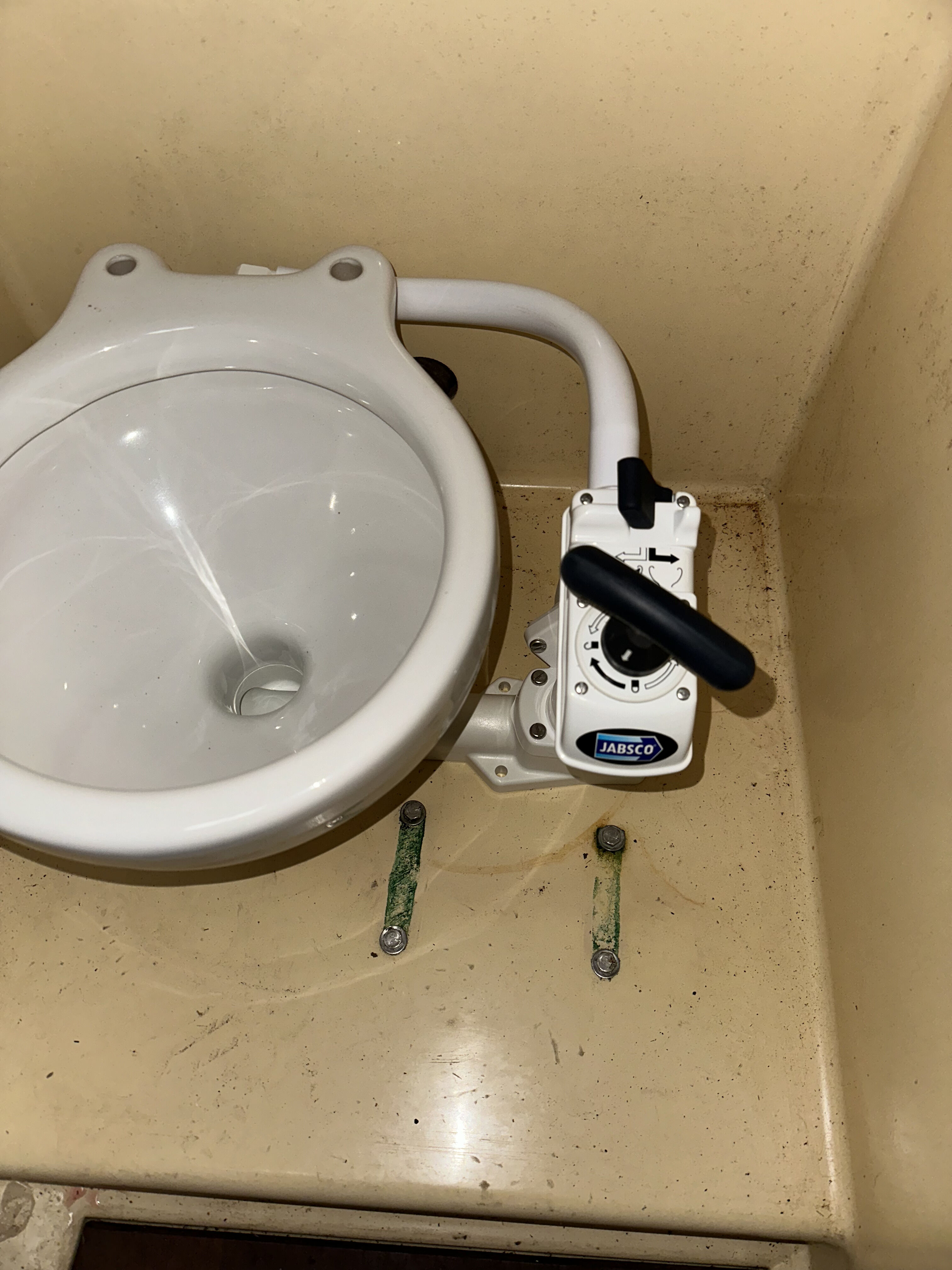

I ended up going with a compact Jabsco twist n lock. I know it’s not everyone’s favorite, but I’ve owned a few in the past and they have always been more or less reliable and odor free (with maintenance and fresh water flush).
I plan on replacing all of the hoses and installing a 5 gallon fresh water tank behind the head for the fresh water flush.

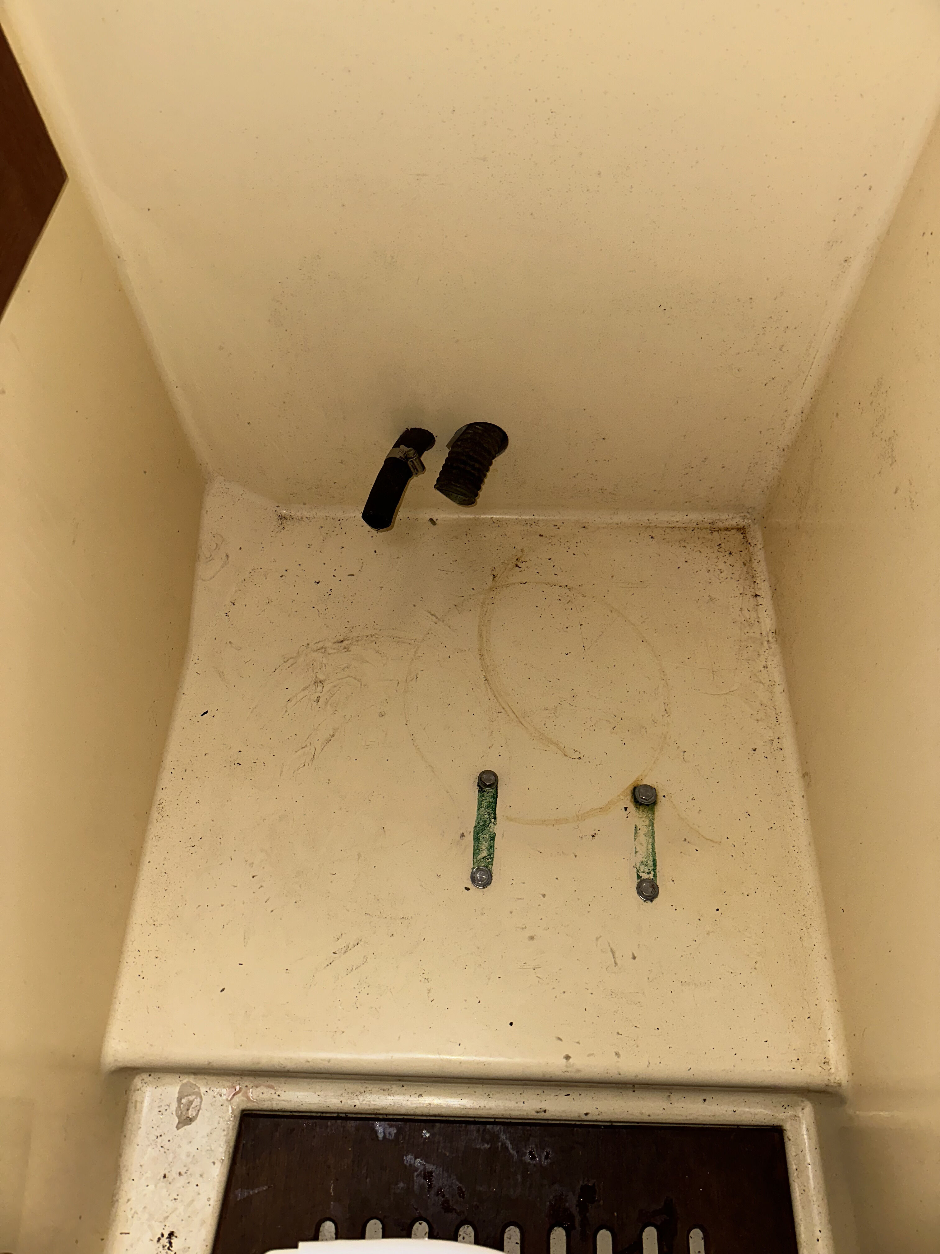

The one issue I haven’t decided on yet, is none of the original bolts line up with the Jabsco. My first line of thought is to cut a piece of 1" starboard and make an adapter plate using the 4 original bolts to the floor. The Jabsco would then bolt to the starboard. Option 2 would be to fill the original holes and through bolt or lag bolt the toilet into the floor.
Has anyone dealt with this issue? Assuming the floor is cored, should I be prepared for rot in the original bolt holes? Does the starboard idea sound viable, or is that just taking the easy way out? The hose holes don’t match up either, but I am 99% going to go the starboard route for that.

If anyone is curious, the floor is cored and the toilet is through bolted. I have zero clue how you are supposed to gain access to the nut underneath, maybe someone knows and can chime in.
I decided to just cut the old bolts off with an oscillating tool, fill the holes with plastic wood, and drop the new toilet over the old patched up holes using lag screws

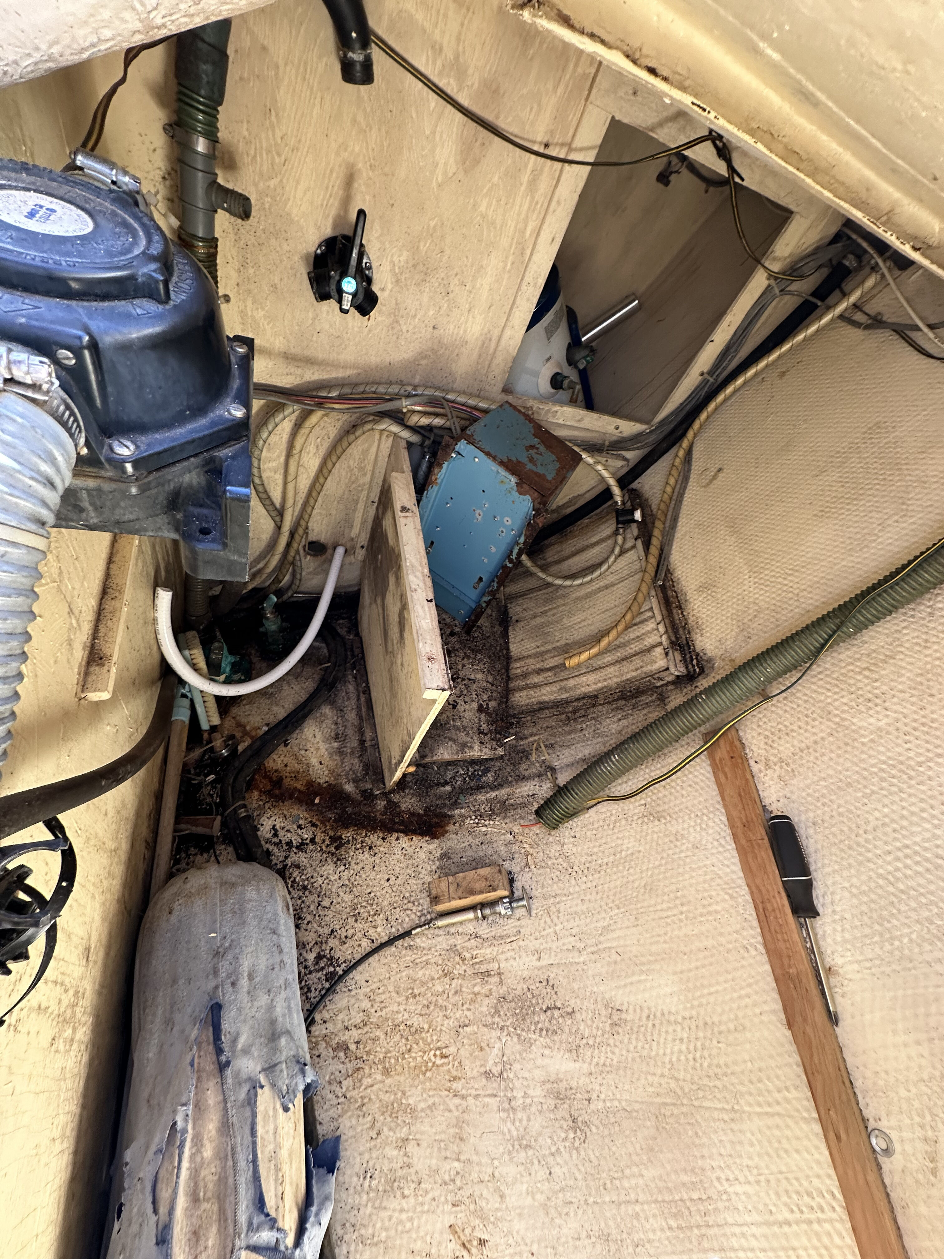

The holding tank was questionable at best, so I cut off the rotting shelf to remove it. I removed the rusted through hot water heater, fresh water pump, and battery charger so I can do a complete overhaul. New sanitation hoses, new 18 gallon holding tank, deleted the ocean discharge and macerator. new hot water heater, new fresh water pump, new battery, and new glassed in shelf with modified holding tank compartment.
