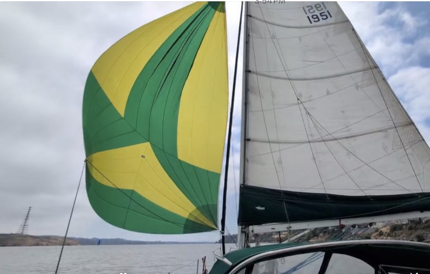

Hello - lots of interest here. I run an asymmetrical using an ATN tacker on my furled headsail and tacked to the fore of my bow roller. Head is to a sheave just above the jib sheave at 7/8 th. I’d be Leary of running a spinnaker or asymmetrical to the mast head as the stresses would be high. Mack Sails told me not to run my asymmetrical in more than 12 kts AWS. - experience has shown me I believe him! I do have an additional sheave at mast head for a second main halyard if needed.

Do you find your asym worth flying? Do you fly it alone or with the main? Is it a pain to set up around the jib boom (assuming you still have it)?

Poor pic but…. ATN tacker on furled headsail, ATN tacked to forward tip of bow roller ( small bow sprint would be better. I added 2 harken 35.2 winches to p/s back of coaming. Works well DDW wing on wing or jibing downwind. Use outside jibe rigging Only use it with at least 1 crew. Use with full main. Novelty.
What’s the difference between flying that and your jib?
I see you’ve rigged your jib on a roller - is it still self tacking? Original size?
The asymmetrical is huge. As far as I can tell the F35 has always had a furler . I put on a new Schafer furler in 2023. It is self tacking - makes life simple.
Right on. What kinda speed increase do you see, on average? And what point of sail do you find it extends to?
(buncha questions since I’m hoping to be running the same ish setup in the next few months)
Wing on wing in 14-15 twos ddw we’ve hit 10+ kts, with full main. With full main at 120 degrees or so in 12-15 AWS similar. Main blanketing the asymmetrical can occur. Small bow sprit or even a pole help that which I don’t do.
Very sporty!
No pole because it’s sketchy to drill the carbon?
It’s true holes in the CF can’t be great - even though we all have many holes already with the mainsail track, etc. - one can use around the mast clamps instead. My reason for not is I don’t use the asymmetrical enough to warrant a pole
