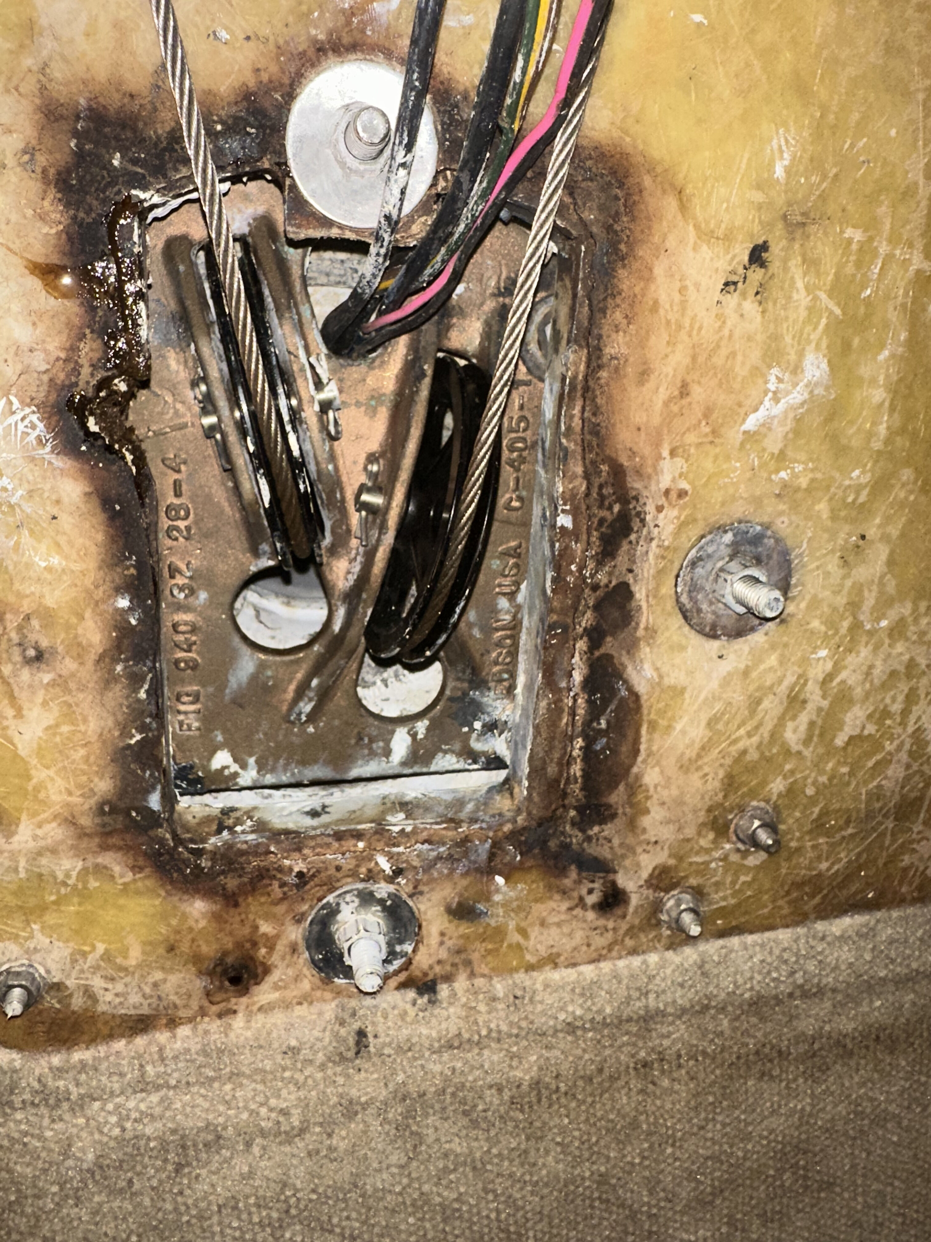

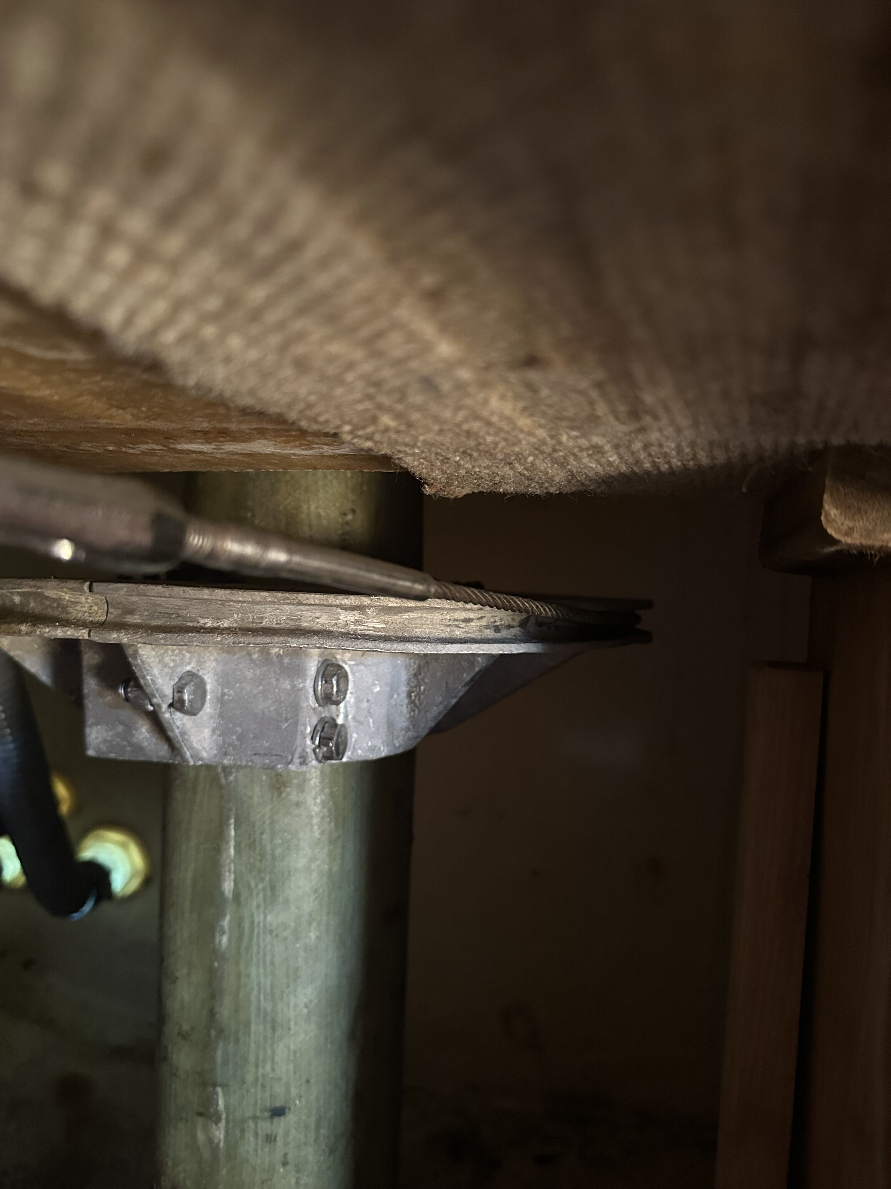

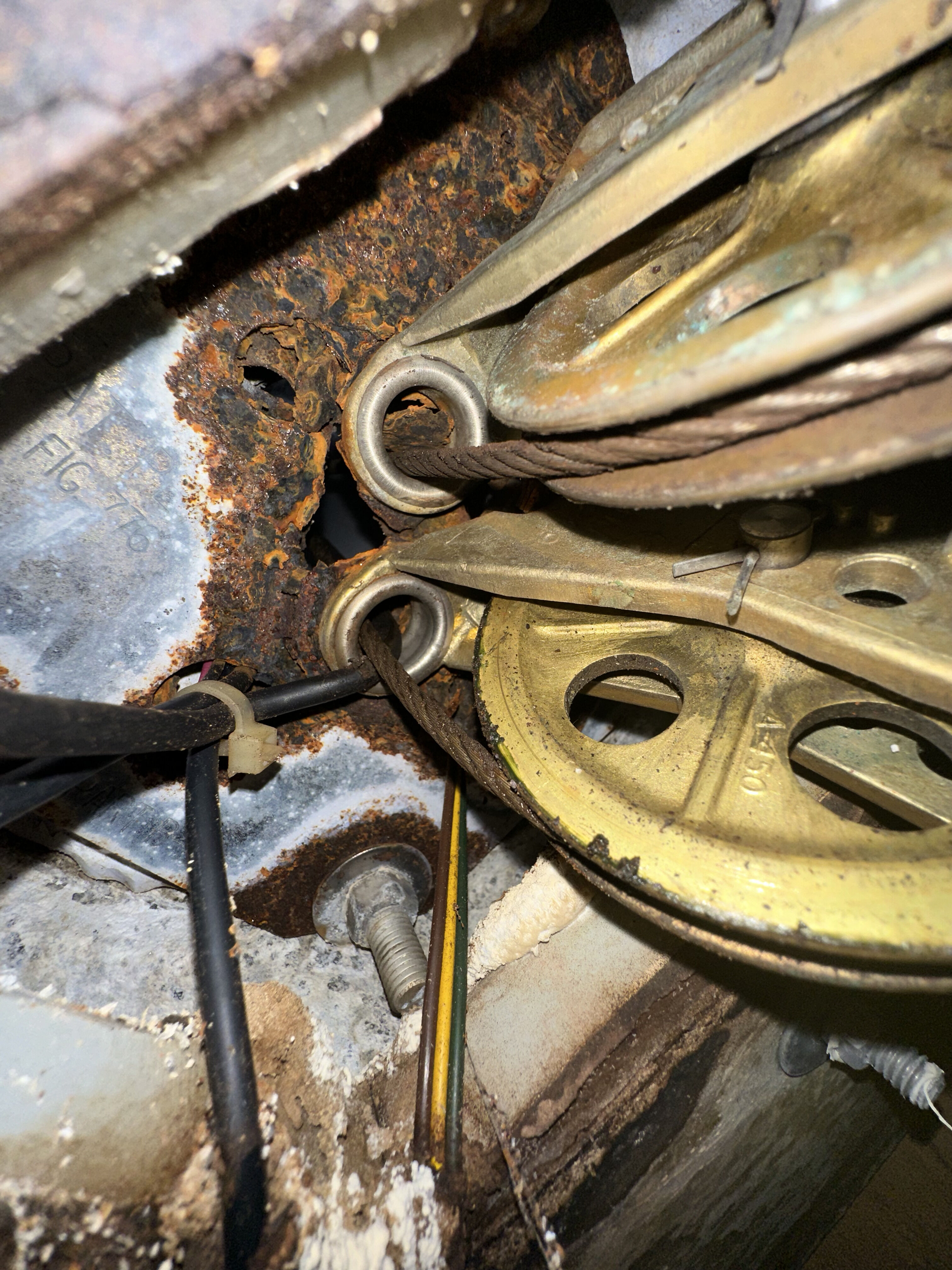

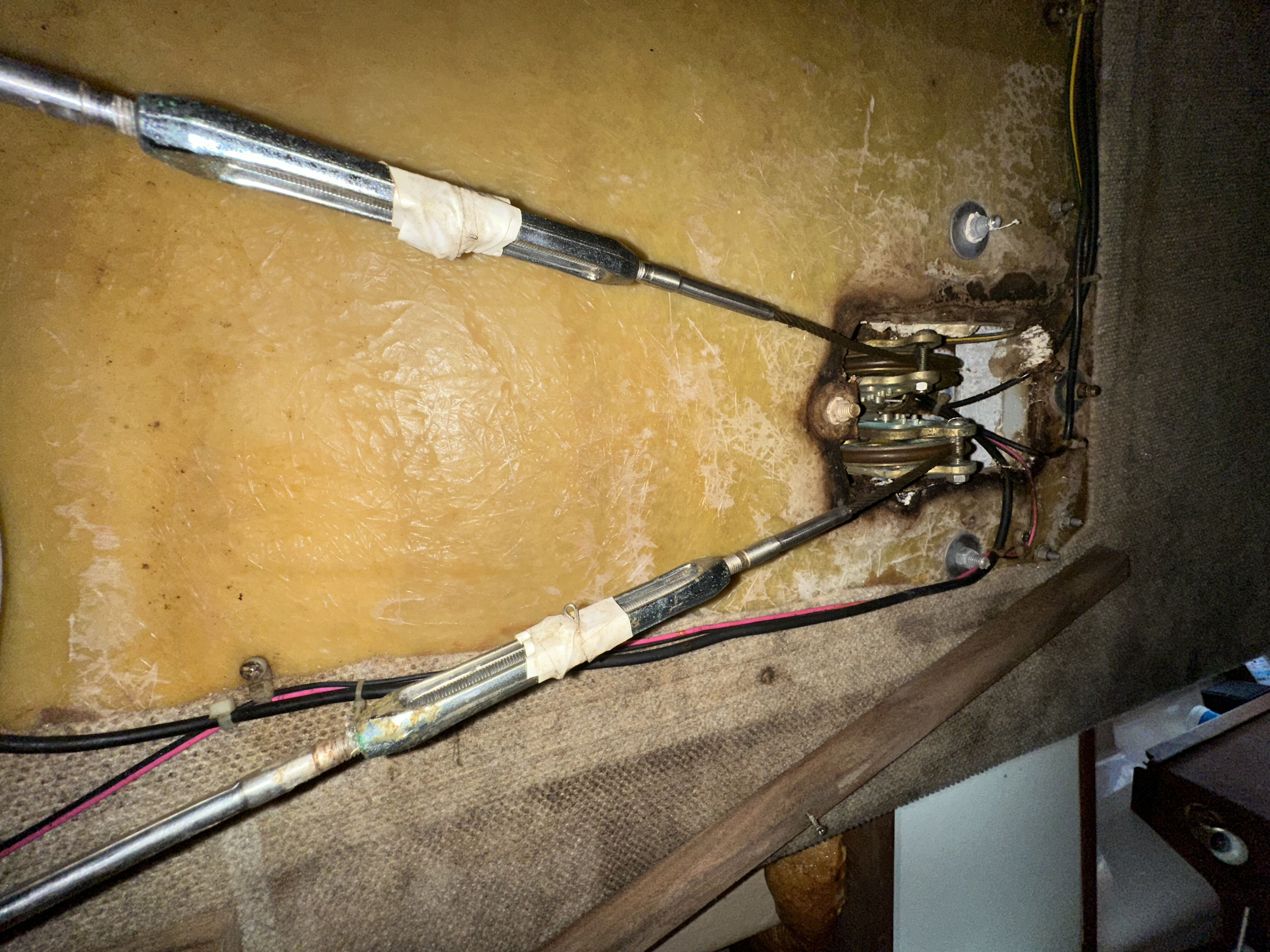

Finally back in business! The idler assembly completely rusted through allowing the pulleys to rip out of the assembly. I got a replacement chain, cable, and recessed idler assembly from Edson which had its challenges. First off, the replacement chain and cable is not a direct replacement to what came original on my boat. Edson assures me that it is the correct one and modification may need to be made. On my radial wheel, I have 2 cables that are attached in the rear which screw into the chain & cable on the pedestal. Does anyone know where to get the replacement that screws in? For now, I cleaned and lubed the old chain, and got a master link to shorten it to accommodate the new idler assembly.
Second hurdle was the new recessed idler assembly is not a direct fit. My marina made a custom plate that raised the idler slightly so it would fit. Not a huge deal, but now the cable is kind of a funny angle relative to the radial wheel. I want to move the radial wheel up about 3/4" to prevent chafing of the cable. Does anyone know that torque spec on the bolts for this?

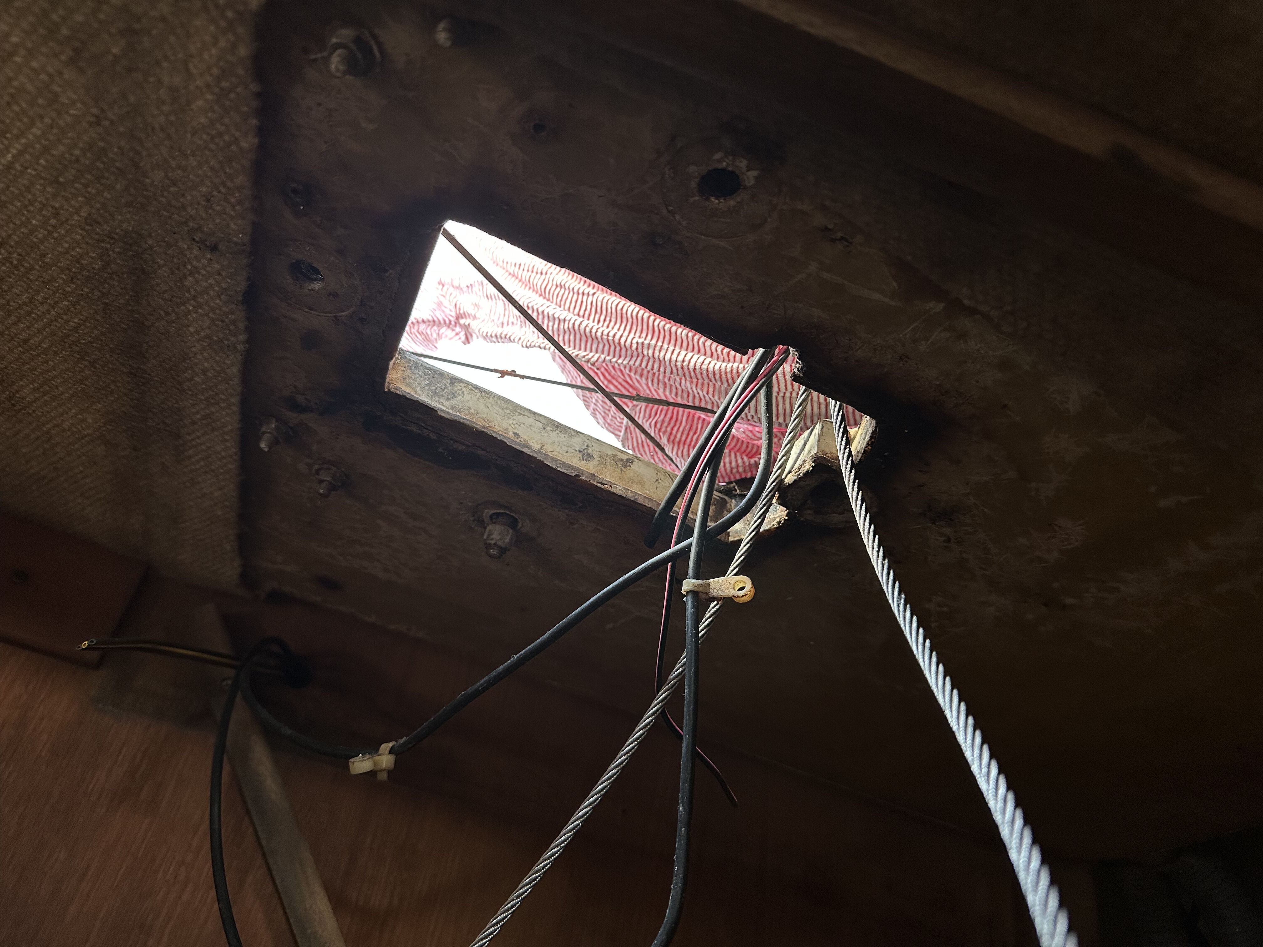

Last thing, which I am debating doing this now or during winter layup…is I have to rewire everything that passes through the pedestal. The marina decided to leave all of my wiring harnesses cut up after I had asked them to remove the pedestal and corroded idler. Not sure if I will wait to rewire the entire boat this winter.
