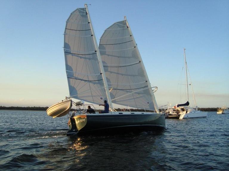

There’s an F33 catketch in Oz, Nightwing (owner David Holt) with a new suit of squarehead sails. He just started using them, so his experience with them is limited at this time. But look at it; the beauty of power…

Now those sails are beautiful. What do you figure 10k main and 8k for mizzen? I have plain dacron and they look good but the “power” in this rig is impressive. Numbknots
David gave me the specs, see below. Sails were made by Ullman sails, an Australian loft for racing catamaran sails. Cloth is Advanced Cruising Laminate (ACL). Total set including batten gear was under US$ 10k. Very competitive price, I think.
Mainsail
Triradial cut mainsail inc 6 full battens, 3 reef points, PNPA 276 luff boxes / PNPA 282 luff slides with M10 links, draft stripes, tell tales and drawstring sailbag.
Triradial cut from Contender Sailcloth ACL 75 Grey
$6,530 (US$ 6000)
Mizzen
Triradial cut mizzen inc 6 full battens, 2 reef points, PNPA 276 luff boxes / PNPA 282 luff slides with M10 links , draft stripes, tell tales and drawstring sailbag.
$3,945 (US$ 3660)
Michel,
That is a great price. My sails came to half that but the work in those sails plus the material and size have to be considered. All things considered that has to be 4 times the product in the end. Computer generated you think? They are impressive.
Numbknots
Yes, the sails were computer designed. I’ve seen the development from the first sketches onwards. David first went for a large round roach but later switched to moderate squareheads. A large round roach tends to make the sail fuller in a blow because the leech compresses the battens. A squarehead keeps its designed shape much better.

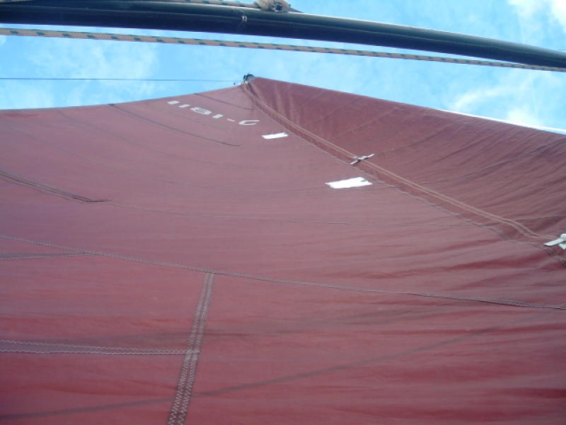

I have added a picture from my archives to illustrate the sleeved sails.
My experience with zippered biminis causes me to shudder to think of what’s going to happen to these sails when the zipper starts “stiffening up” with salt & age, as it inevitably will. I can see using this approach on a dry sailed day sailer where the sails are removed (and maybe even washed clean) after every use, but not otherwise. Nevermind that zipper failure would result in either outright loss of the sail or, at the very least, a situtation where your “repair” would essentially destroy it.
